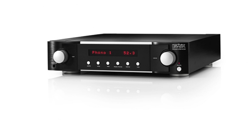

¸¶Å©·¹ºó½¼ÀÇ ¾ó±¼°úµµ °°Àº Àü¸éÀÇ Èò º¼·ý ·¹¹ö´Â °³º° ÀúÇ×À» ÀÌ¿ëÇÏ´Â R-2R ladder ¹æ½ÄÀ¸·Î ¼³°è µÇ¾ú´Âµ¥,
ÀÌ´Â ¾Æ³¯·Î±×ÀÇ ´À³¦À» Àß Ç¥ÇöÇØ³»´Â °í°¡ÀÇ DAC¿¡¼­ ÁÖ·Î ¾²ÀÌ´Â ¼³°è·Î, ÀúÇ×À» »ç´Ù¸®¸ð¾çÀ¸·Î(ladder) ±¸¼ºÇØ
±â°èÀûÀÎ Á¢ÃËÀÌ ¾ø¾î ±âÁ¸ ¹æ½ÄÀÇ ÀúÇ×µéÀÌ °®´Â ¼º´ÉÀÇ ¿­È­¸¦ ÃÖ¼ÒÈ­Çϰí, Á¤¹ÐÇÑ ÀúÇ× °ªµé¿¡ µû¶ó Àü·ù·®À» º¯È­½Ã۱â
¶§¹®¿¡ 0.1 ´ÜÀ§·Î ÃÎÃÎÈ÷ ¿òÁ÷ÀÌ´Â, »ç¿ëÀÚÀÇ ÀÔÀå¿¡¼­ ¸Å¿ì Á¤È®ÇÏ°í ¼¼¹ÐÇÑ º¼·ý ÄÁÆ®·ÑÀ» °¡´ÉÇÏ°Ô ÇÕ´Ï´Ù.
º¼·ý ³ëºêÀÇ ¸Å²öÇÑ °¡°ø »óųª, ³ëºê¸¦ ¼ÕÀ¸·Î µ¹¸±¶§ÀÇ ´À³¦µµ ¸Å¿ì ÈǸ¢ÇÏ¿© ÀÌ·¯ÇÑ µðÀÚÀΰú ¸¶°¨Àº »ç¿ëÀÚÀÇ ¸¸Á·°¨À» ´õ¿í »ó½Â½ÃÄÑÁÝ´Ï´Ù.

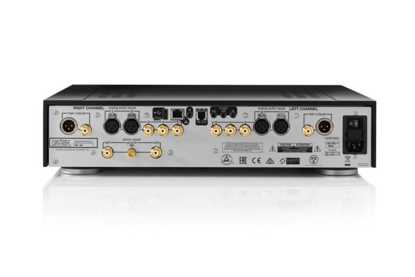

¸ðµç ½ÅÈ£´Â ±ÕÇüÀâÈù ½Ì±Û¾Øµå ½ºÅ×·¹¿À Ãâ·ÂÀ¸·Î ³»º¸³»¸ç, ÇÁ·ÐÆ® Æä³Î¿¡´Â ¸¶Å©·¹ºó½¼ Á¦Ç°µé Áß ÃÖÃÊ·Î ¸ÞÀÎ µå¶óÀ̺ê ÇìµåÆù Ãâ·ÂÀ»
°¡Áö°í ÀÖ½À´Ï´Ù. ¸ÞÀÎ µå¶óÀ̺ê ÇìµåÆù ¾ÚÇÁ ȸ·Î´Â º¸Á¶ ½ÅÈ£ °æ·Î¸¦ »ç¿ëÇÏ´Â ´ë½Å ¸ÞÀÎ Ãâ·Â ȸ·Î¸¦ »ç¿ëÇÏ¿© A Ŭ·¡½º Ãâ·ÂÀ¸·Î 32¿È ÇìµåÆù±îÁö ±¸µ¿ÇÒ ¼ö ÀÖ½À´Ï´Ù.
ÀÌ´õ³Ý, RS-232, DC Æ®¸®°Å, IR ¸®¸ðÄÁÀÌ ÀÖÀ¸¸ç ¸ð´ÏÅ͸µ°ú ³×Æ®¿öÅ© ÄÁÆ®·ÑÀ» À§ÇÑ USB ´ÜÀÚ°¡ ÀÖ½À´Ï´Ù.

Analog inputs 2 balanced (XLR), 3 single-ended (RCA) line, 1 single-ended (RCA) phono w/ ground
Analog outputs 1 balanced (XLR); 1 pair single-ended (RCA), 1 headphone (¨ù¡±, 6.3mm TS)
Control connectors Ethernet (RJ45), RS-232 (RJ12), Trigger In and Out, IR In, USB-A, Mini USB
Mains voltage 100VAC, 115VAC, or 230VAC, factory set
