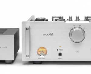

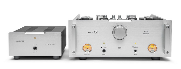

1.The up-grade model of legendary H-3000V, all transformer coupled LCR phono stage.
2.World premier Three Inputs mode, this is a long wish of vinyl lovers,
 having tri inputs in one machine, head-amplifier (pre-pre or electronic step-up) input,
 traditional step-up transformer input and MM direct input(you can connect your favorite step-ups also).
3.LCR Equalization. On the contrary to the traditional CR or NFB
 equalization of high impedance (hundred kilo ohms), LCR uses 600 ohms¡¯ constant impedance,
 a big difference on frequency range and energetic operation.
4.LCR Multi-curve Equalization. This is also world-premier, Allnic¡¯s Multi-curve
LCR unit has 4 turn-over(250Hz, 400Hz, 500Hz RIAA and 700Hz) and
4 Roll-off(-16dB, -13.7dB RIAA, -11dB and -5dB), this means you can enjoy
playing any LP before RIAA standardization.
5.In additional, the H-7000V features,
– The H-7000V phono stage is all transformer coupled, no coupling capacitors.
– Non negative feedback design with only two active gain stages.
– For superior signal to noise ratio, the H-7000V is equipped with pure
vacuum tube, high speed, automatic voltage regulation circuit for both channels
 and a power supply unit separate from the phono stage itself.
– High quality wide frequency in-house MC step-up
transformers are used for the H-7000V¡¯s MC2 input.
– Pure balanced operation.
– Pure class A operation.
– For main amplification, Allnic uses 4 pentode E810F tubes as
 in triode mode(please see its wonderful three factors, ¥ì= 57, gm = 50,000 micro mho,
and lowest resistance around 1 K ohms). This tremendously beautiful tube drives
 so well our 100% permalloy PC big output transformer at 20mA high current.
– Our incorporated head-amplifier operates in so high S/N ratio,
 you can enjoy the darkest background during your vinyl playing.
