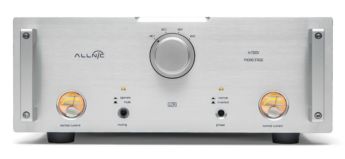

1.The up-grade model of legendary H-3000V, all transformer coupled LCR phono stage.

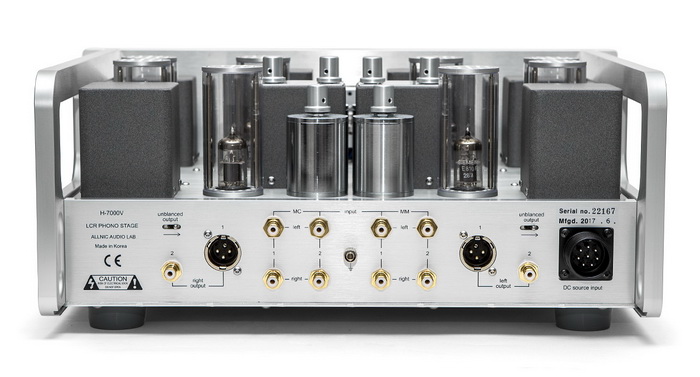

2.World premier Four Inputs mode, this is a long wish of vinyl lovers,
having four inputs in one machine, two traditional step-up transformer input
and two MM direct input(you can connect your favorite step-ups also).

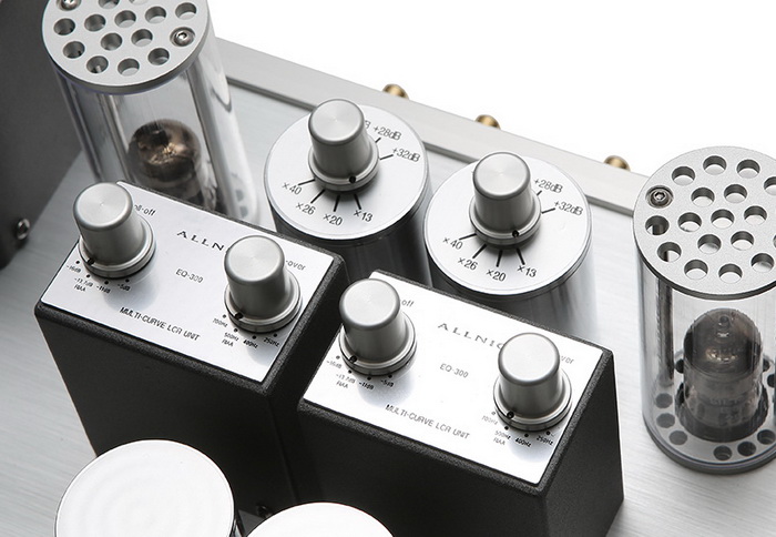

3.LCR Equalization. On the contrary to the traditional CR or NFB equalization
 of high impedance (hundred kilo ohms), LCR uses 600 ohms¡¯ constant impedance,
a big difference on frequency range and energetic operation.
4.LCR Multi-curve Equalization. This is also world-premier,
Allnic¡¯s Multi-curve LCR unit has 4 turn-over(250Hz, 400Hz, 500Hz RIAA and 700Hz)
 and 4 Roll-off(-16dB, -13.7dB RIAA, -11dB and -5dB), this means you
can enjoy playing any LP before RIAA standardization.

– The H-7000V phono stage is all transformer coupled, no coupling capacitors.
– Non negative feedback design with only two active gain stages.

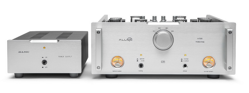

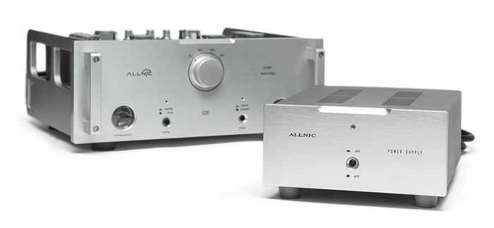

– For superior signal to noise ratio, the H-7000V is equipped with
pure vacuum tube, high speed, automatic voltage regulation circuit for
 both channels and a power supply unit separate from the phono stage itself.
– High quality wide frequency in-house MC step-up transformers are used for the H-7000V¡¯s MC input.
– Pure balanced operation.
– Pure class A operation.
– For main amplification, Allnic uses 4 pentode E810F tubes as
in triode mode(please see its wonderful three factors, ¥ì= 57,
gm = 50,000 micro mho, and lowest resistance around 1 K ohms).
This tremendously beautiful tube drives so well our 100%
permalloy PC big output transformer at 20mA high current.

¿Ã´Ð H-7000VÀº ÀÔ·ÂÀÌ 4 °³·Î Æí¸®ÇÏ°Ô »ç¿ëÇÒ ¼ö ÀÖ½À´Ï´Ù.
 ±×°£ H-3000Vµµ Æ®·£½º³ª ºÎǰ µîÀ» ¸Å³â °³¼±µÇ¾î ¿ÔÁö¸¸
H-7000V´Â H-3000V¸¦ °è½Â¹ßÀü½ÃÄ×½À´Ï´Ù. MC1, MC2 – STEP
UP TRANS, MM1, MM2 – MM À¸·Î 4°¡ÁöÀÇ ÀÔ·ÂÀ» ÁغñÇÏ¿©
¾Æ³¯·Î±×ÀÇ ¸ðµç Áñ°Å¿òÀ» ´©¸± ¼ö ÀÖ½À´Ï´Ù.

H-7000V´Â Äܵ§¼­°¡ ¾Æ´Ñ Æ®·£½º·Î¸¸ ¿¬°áµÈ LCR¹æ½ÄÀÔ´Ï´Ù. ±×°Íµµ
RIAA CURVE¸¸ÀÌ ¾Æ´Ñ MULTI- CURVE¿¡ ´ëÀÀ °¡´ÉÇÑ Æ®·£½º°¡ žÀçµÇ¾î
ÀÖ½À´Ï´Ù(ÀÌ ¿ª½Ã ¼¼°è À¯ÀÏ). ¿Ã´ÐÀÇ ¸ðµç Á¦Ç°ÀÌ ±×·¯Çϵí Áøµ¿À»

* º°µµ Àü¿øºÎ ¹× °íǰÁú MC ½Â¾ÐÆ®·£½º ³»Àå
